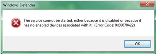

    Windows Defender Error 0x80070422
    error
    Attached Thumbnails Attached Thumbnails Windows Defender Error 0x80070422-pic.jpg

    If it worked before and it's giving you an error now, you may have been infected. How does your antivirus work? Will it update?

    Try to start the windows defender service from the services.msc, make it automatic and start the service the reboot the computer it should work...

    the problem can also be caused by BITS - Background Intelligent
    Transfer Service , try to go to services.msc and restart the BITS service , or try to set it to manual or auto and restart the pc .U could also try something like this, make a new txt on desktop in notepad an paste
    "sc config wuauserv start= auto
    sc config bits start= auto
    sc config DcomLaunch start= auto
    net stop wuauserv
    net start wuauserv
    net stop bits
    net start bits
    net start DcomLaunch "
    without the "" and safe , after that rename it to test.bat , and after that run as admin.
    Probably it also could be a virus , would recommend to install malwarebytes and run a quick scan , if it founds something delete restart and try again. If same , download HijackTHis and post a log , or send it to me ..

    I had this error code - here's how i fixed it -
    Type 'services' into start menu search. Click on services. Scroll down to 'windows firewall' right click, choose 'properties' half way down to start up type select 'automatic' click 'apply' and then reboot. My problem solved. If your problem is with Wondows Defender then choose that instead of firewall
    My problems started after trialling and then removing Norton Internet Security 2009.
    Hope this helps
