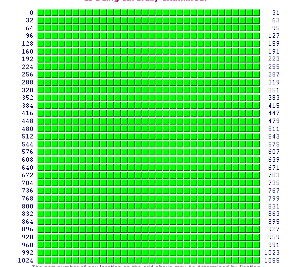

what on earth.... why are those 3 stealthed but the others arent? that looks like your ISP is stealthing those ones for you, but Windows Firewall is not doing its job clearly.... i would say try a repair install to sort it out, but maybe someone else will come up with something different first
are you behind a router with NAT enabled? is your computer in the DMZ?
here is mine, sitting behind a NAT Firewall with Windows Firewall, port 100 is open on the router, but as you can see Windows Firewall is stealthing it when not in use

problem is, if you actually physically lock down all your ports you won't be able to use the internet, as your computer just won't respond to requests from any Ip address (even if its supposed to)
try opening up a command prompt as administrator, and running sfc /scannow see if it finds a problem with the firewall files
might be worth doing a scan with Malwarebytes as well: http://download.cnet.com/Malwarebyte...=dl&tag=button just on the odd chance you have got something nasty by accident

yes, ALL boxes should be GREEN, if they are BLUE then you are not "STEALTH" = visible to others.
Windows Firewall should give you green boxes, if it doesn´t then you have a problem.
as posted above, do a scan for malware, i suggest you download a-squared: http://www.emsisoft.com/en/software/free/
but the easiest way to solve the problem is to change firewall, get Comodo...
