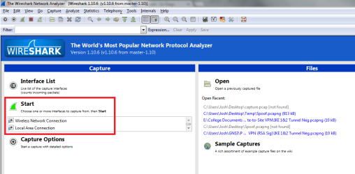

Wireshark is a free open source protocol analyser and will allow us to filter out the extraneous traffic. Unfortunately no packet capture will filter traffic at capturing but afterwards when reviewing traffic it can be filtered.
Wireshark · Go Deep.
If you can, run the capture when you receive the error so we can see the bad HTTP requests sent out and possibly investigate what traffic is being sent back to you from the server which could help with identifying the problem.

To start the capture first open the application after installation. After this choose the interface that you wish to capture traffic on (This should be the interface you use to connect to the internet/web server). Then click on the start button.
After this it should begin to capture the traffic and you will see some action happening in the table. This is all the network traffic that is being sent to and from your machine and is being captured. During this try and replicate the error message you are getting so we can see the packets in more detail in the capture. After that is done simply press the stop button to stop the packet capture.

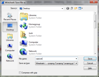

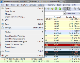

Now that the capture has been stopped you can now save the capture by clicking on File > Save As...
Give it a name and make sure you save it as a pcap file. It should be the default file type anyway.
Now that the capture has been saved please place it into a ZIP folder and then attach it to your next post and I will have a look and see if I can find anything in the packets that could indicate the potential problem :geek:
