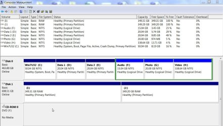

1. Post a screenshot of how your external drive appears in Windows Disk Management.( Please plug out any other USB Storage device/s) http://www.sevenforums.com/tutorials/274797-disk-management-post-screen-capture-image.html
Just an example. Disk 1 is my two partition external GPT drive that I had turned RAW.
Let us see how your 4TB drive looks like.

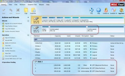

3. Please download and intall MiniTools Partition Wizard edition 9.0
Free download Magic Partition Manager Software, partition magic alternative, free partition magic, partition magic Windows 7 and server partition software - Partition Wizard Online . Run it and post a screenshot with your 4TB external drive connected.
Just an example: This is how my GPT drive that had turned RAW - rather I made it turn RAW - looks like.
Now post your screenshot.
( Your screenshots may look different depending upon what made it RAW. Nevertheless it may give a clue as to what happened and research further.)

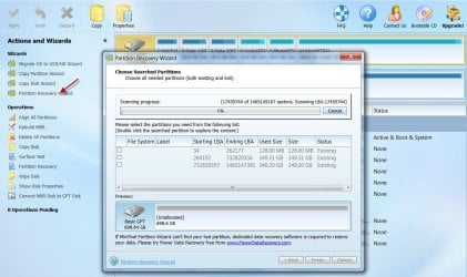

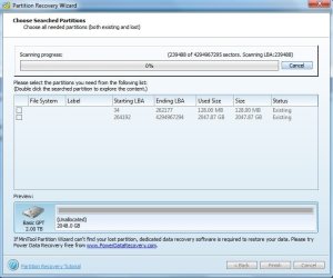

Now go ahead with Partition Recovery.
Click on Partition Recovery Wizard on the left Pane > Next > Select your external drive > Next > Full Disk > Next > Quick Scan > Next
Even as the Quick Scan is in progress, do a screen capture and post the screenshot.
Example:
Even as the Quick Scan is in progress, post the above three screenshots and wait for further instructions. ( Mostly I will be online at that time)
Since the Quick Scan on a 4TB, may take hours, leave it alone and do your other work peeping in once in a while to check the progress.
When Quick scan completes , post the resulting screen showing the partitions.

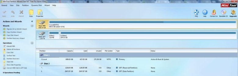

When i bought the drive, i had a hart time formatting it in my vantec enclosure. It was reporting the drive as only 2tb. I changed the vantec for another one that i had and that did the trick. But i remember doing research on mbr et gpt without comprehending everything and i think i had to make a choice between the two at that time.
I had no problem with the disk for a couple months and i'm pretty sure the problem started when i did over 2TB on the disk. Even if vantec usa told me that my enclosure can manage higher than 4TB disk, i'm not so sure anymore.
Here are the picture i have for now. Don't matter the different letter for the 2 images, i did this in two separate computer (i can't run wdm on one of them)
First image is windows disk management and the drive is F.
Second image is mini tool and the disk is number 2.
Third image is recovery wizard.
Bye :)

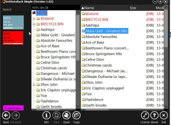

For now, download GetDataback Simple Data Recovery Free download and install it. https://www.runtime.org/data-recovery-software.htm
Here I am going to recover my faulty GPT Drive Disk 1
Almost immediately both my RAW partitions are shown in the next screen.
I click on the first partition and within seconds I see all my files /folders in it. Right click on the folder and I can copy it - provided I pay for the licence USD 79 or so.
Just try and keep this option open.

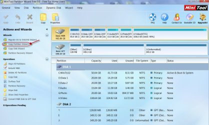

Another method I learnt from Kaktussoft:
Use the Copy Partition Wizard in Partition Wizard and copy the RAW parttion to another emty external drive. You have to have another empty 4TB external drive connected. I do not know whether you can use a less than 4TB drive and partition Copy will be successful.
Windows 7 Home Premium 32 bit

Surely it is a problem with incompatible enclosure.
Your screenshots on two different computers does not help. Can you not run PW on the same computer on which you did the WDM screenshot?
I have heard this problem with Vantec enclosures. What I have understood is that on reaching 2 TB, it wraps around and starts writing from the beginning.In the process the GPT data as well as the first Volume Boot record at sector 264192 is overwritten and is lost.
Did you format it as a GPT drive on the second enclosure? Is it also a Vantec enclosure?
I would think you should limit yourself to 2TB drives on your Vantec enclosures.
Whether you can restore the GPT data from the backups in this case, I am not sure. If immediately after formatting the drive as GPT you had saved sectors 0, 1 ,2, 264192(VBR) and sectors n and n-32 perhaps you can.
As far as I understand where the volume boot record is lost, the only option is data recovery and then format.
If there is no need for data recovery then use your Seagate 4TB drive as an internal drive and format it.
