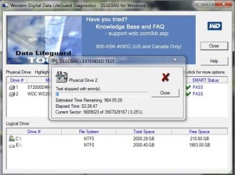

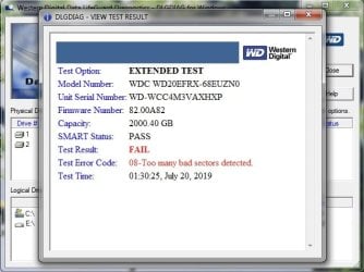

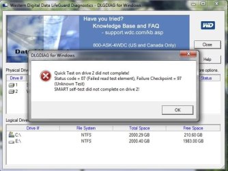

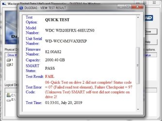

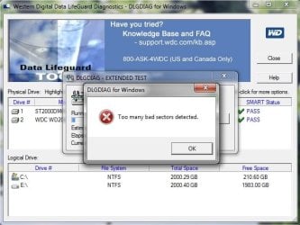

Here are the results from Data Lifeguard Diagnostic from WD’s website:
Does this mean my hard drive’s done? Can I still do something?

In technical terms it's knackered is this still external there is a slight chance it's the interface and if you plug it in to the pc as a second drive and test again it may be ok if the fault is the interface not the drive it's worth a shot

I suppose that WD Red is a 3.5" internal disk.
Too many bad sectors means your drive has failed.

Your disk has a hardware failure, that cant be fixed. Bad sectors means that the disk surface is damaged. Normally it happens when the head touch the surface due to drastic disk move.
