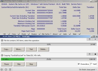

I uninstalled v3 restarted installed v2.3, it was working fine then uninstalled v2.3 and installed v3 again and still the same problem.
I did some more testing with v3 and it LOOKS LIKE Teracopy 3 uses system cache by default for small files (< 300-400 MB).
I moved a few big files (1-3 GB) from my internal HDD to the external one just for testing and the average speed was 25 MB/s (the same as Fastcopy) and it didn't freeze like it did when copying/moving small files.

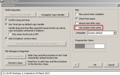

Actually I've just checked my version of Teracopy and it's 2.3 - maybe try going back to 2.3 and see if you still get the same problem.

And thank you I'm aware of that system cache option in v2.3.

Is there any way/method to know whether Teracopy uses system cache or not during file transfer ?

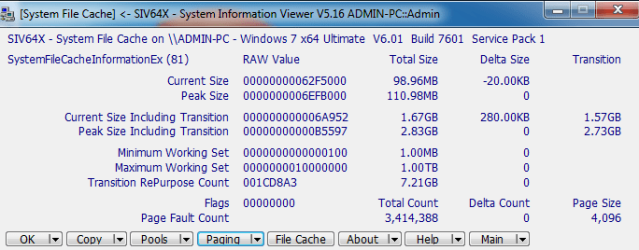

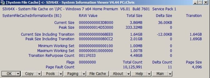

I did read but obviously not with enough care. :o

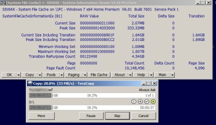

Anyway here's two screenshots showing System File Cache before and during a large file copy using 2.3 with cache option unchecked in preferences. Give us a while and I will try updating Teracopy and compare results.

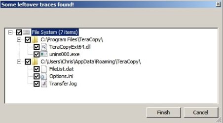

Okay I updated Teracopy.
Problems with leftovers that needed removal ingluding Teracopy shell extension. If you didn't remove the old one I guess it could cause problems.

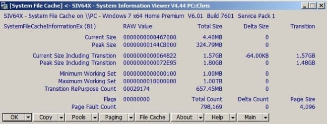

No problems with speed or freezing with the new vwrsion of Teracopy after a complete removal, a reboot and a fresh install of Teracopy 3
before copy
during copy

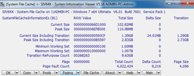

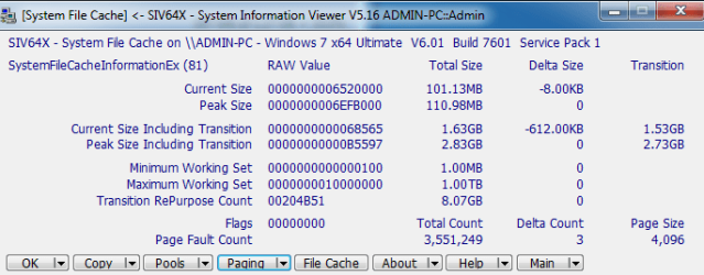

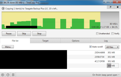

Sorry for the late reply mate.
https://www.sevenforums.com/attachment.php?attachmentid=397004&stc=1&d=1488735502
Before file transfer.
https://www.sevenforums.com/attachment.php?attachmentid=397005&stc=1&d=1488735502
During copying (Small files).
https://www.sevenforums.com/attachment.php?attachmentid=397006&stc=1&d=1488735502
During copying (Big files).
https://www.sevenforums.com/attachment.php?attachmentid=397007&stc=1&d=1488735502
As you can see it fluctuates very much for small files and there's at least 5 s freeze between each file.
https://www.sevenforums.com/attachment.php?attachmentid=397008&stc=1&d=1488735502
For these big files there's no freeze between them.
To be honest I don't know what those numbers and values mean in SIV, could you please have a look and see whether there's a problem ?

I've been away and offline for a week. What was the file size for your copied file?
Your file cache is 10 times the size of mine but I'm not sure why that is.
There were no issues with Teracopy 3 on my machine and no freezes or delays.
