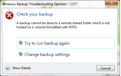

Hey Guys,
I recently setup a Home Server to have Windows 7 automatically backup. The home server has a 1TB HD and I've set full permissions for everyone in my network but the problem is Windows 7 will go so far with backup and then all of a sudden it will stop and say it can't be completed.
Then if I click Details it just comes up and says Access denied. Whats up?

Looks like your backup destination drive needs to be in NTFS format. Can you confirm this is the case please? :)

Hey Guys,
I recently setup a Home Server that allows me to automatically backup my computer files to the network server. The server is running Windows 7 Ultimate but I've slimmed a lot of things down and turned off a lot. It has two hard drives
1. 40GB HD - With the OS
2. 1TB HD - For storage
Each time I try to backup my files I get an error so far the errors have been the following:
  • The backup was not successful. The error is: Access is denied. (0x80070005).
  • The backup was not successful. The error is: The system cannot find the path specified. (0x80070003).
  • The backup was not successful. The error is: The system cannot find the file specified. (0x80070002).
  • The backup was not successful. The error is: A backup cannot be done to a remote shared folder which is not hosted on a volume formatted with NTFS. (0x807800B0).
and
  • The backup operation that started at '‎2009‎-‎10‎-‎22T22:03:36.307200000Z' has failed with following error code '2155348315' (Windows Backup encountered an error when accessing the remote shared folder.). Please review the event details for a solution, and then rerun the backup operation once the issue is resolved.
  • The backup operation that started at '‎2009‎-‎10‎-‎22T22:25:55.987200000Z' has failed with following error code '2147942402' (The system cannot find the file specified.). Please review the event details for a solution, and then rerun the backup operation once the issue is resolved.
Sometimes if I click View Details to see what went wrong it will just come back with "Access Denied" resulting in this in the Event Viewer: The backup was not successful. The error is: Access is denied. (0x80070005).
I would love to use backup, but I can't get it working. Please help.
