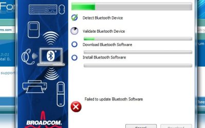

Looking back, it's sad that I must admit Bluetooth issue are exclusive from each other. I'm confident that had I simply installed ALL updates before installing the BT device, there would not have been a problem. As I had mentioned (in disbelief) that the same BT device had been working fine with Pro 7, I failed to take into account that it was completely up to date. This time, I restored to factory image, re-upgraded to the Pro, and without taking a breath, attempted to install the Bluetooth emulater immediately. Obviously there will be hundreds of updates necessary when the initial "ISO" is from Windows Starter @ 2009. I'm thinking to myself.....STUPID!!!!:confused: thanks so much for everything.
Respectfully, Patrick
