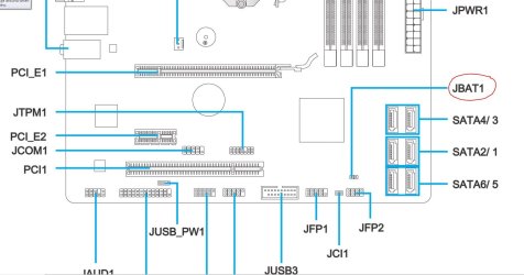

I wonder if you are missing a jumper?
The manual makes it sound like there is one.
