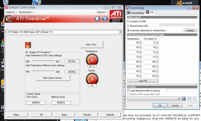

  • Screenshot from 2014-03-17 07:20:30.png
I found a program called ati tool.
FAN speed does not change that can tell when making adjustment.
Clock speed does change as shown in CCC.
What can I twirl to show fan speed in ccc? How much will it cost $ to pay to make ATI show fan speed?
  • Screenshot from 2014-03-17 07:29:21.png
Installed GPU-Z and it shows fan at 20% when idle, and 25% when running WMC, so I have no clue what is really going on, maybe it is running slow. Rather than %, is there a real time rpm meter?
