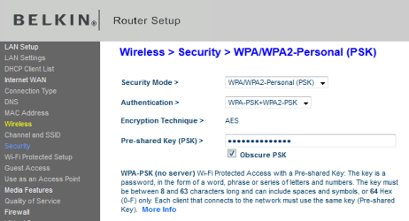

You do this in the Wireless Security setting of your router.
What is the make and model number of your router?

Thanks so much for your reply, but I managed to resolve the issue.
I changed the setting on my router to WPA2, which solved the problem, but meant that my xbox could no longer connect. (Any clue if Xbox has WPA2 support?)
So I changed my router back to WEP and then eventually found a way to set my computer settings to WEP as well. Seems to be working okay now, although it feels a bit more like a work-around than a solution.
