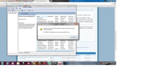

See this :confused:Untitled.jpg

But why would anyone use ICS if they already have a wireless router?
The ICS service has many other dependencies "other services" that must also be enabled in order for it to work. The link below shows what is required. You also need to use a WHQL Microsoft certified driver with the virtual WiFi driver installed in order to have ICS working.
Windows 7 Internet Connection Sharing issue "(null)" - Microsoft Community
I won't spend much time here getting ICS to work, it's unreliable at best and hardly worth using, I say this because all I see is countless complaints about using it. By all rights, you should be using a router for wireless connections.

Which of these services aren't started? Which of them can't be started manually? Post error message
