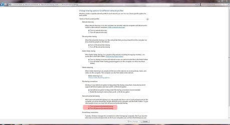

You may need to turn off password protected sharing in Homegroup's advanced settings.
