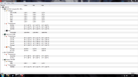

Hello Pauly! I'm using HWmonitor to check my temperatures. I've attached a print screen of the temps. Today i've tried turning my pc on, and i didn't hear a "bip", which indicates the pc boot (i think). I've experienced some high temps. from my cpu this month. But it was only when i was logging into my league of legends account. Do you think could be a HD related problem?

I wouldn't think so but anything is possible with computers my friend
Personally I would keep that page active and continue normal use and monitor temps and you play your game, if they rise to fast or go to high I would investigate further but as you say you have already noticed high temps from cpu I would play it safe and address that issue now anyway
CPU heatsinks can get very clogged with dust so may be time for a clean if that doesn't help then you can try reapplying thermal paste
Also check your gfx temps and ensure all fans are spinning and operate freely, I always open up my machine and clean out dust etc 1-2 times a year minimum its amazing how quickly dust can accumulate in PCs

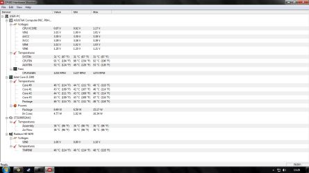

I've attached another print screen from the temps, just to show you what happens when i log into the game. The reason why i think it was the HD is because it won't boot after this problem happens. I need to turn it off/on quite a few times for it to boot. In League of Legends my temp is aout 70ºC. Since i've noticed i've started to monitor the temp. more frequently. I'll keep track of my temp., but in the meantime is there any test i can do to figure this thing out? Thank you for your help :)

The reason I figured that it may be temps is because it will not reboot straight away, several reboots = cooling down ??
The clean startup may be worth a try but if it is temps it wont help, its up to you
