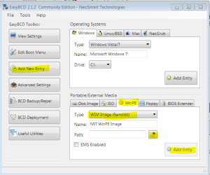

Have you Marked Recovery Partition Active to try to boot it at restart?
Restart Win7 by moving Active flag back to C or System Reserved partition, then run Startup Repair - Run 3 Separate Times.
Now install EasyBCD to Win7, on Add Entry tab add WinPE RAMDISK entry, name it HP Recovery, browse to the Recov partition's Recovery.wim or Boot.wim file after unhiding System and Hidden files in Control Panel>Folder options>View. EasyBCD (free Download at bottom of page - no name or email required)
Now reboot, from Boot menu choose HP Recovery or RamDisk entry to boot into Recovery.
If this fails your Recov partition may be corrupt. Try making Recovery Disks from it, order from HP Tech Support or get the superior Clean Reinstall - Factory OEM Windows 7 without all the HP bloatware.

I've done exactly that trick with EasyBCD earlier today. It worked very well, I could from my normal C: system partition boot (chose between Win7 or WinSetup) and boot directly into R:\sources\boot.wim. That launched immediately the OEM Win7 Installer.
However, there is a drawback; it requires a normal functioning bootloader in the system partition. If for some reason my system (C: ) partition would totally fail, then I don't think the same trick would still work for the simple reason that C:\boot\bcd would be out too. In such a case direct booting into the recovery partition is the only elegant solution.
So it would be nice if I could debug the recovery partition's Bootmgr/bcd and repair the problem.

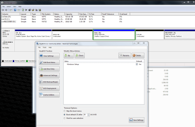

Please post back a screenshot of your maximized Disk Management drive map and listings:
1. Type Disk Management in Start Search box.
2. Open Disk Mgmt. window and maximize it.
3. Type Snipping Tool in Start Search box.
4. Open Snipping Tool, choose Rectangular Snip, draw a box around full map and all listings.
5, Save Snip, attach using paper clip in Reply Box.
Tell us what is on each partition.
C: is the currently booted system partition
D: is data partition
F: the recovery partition
EasyBCD pane contains content of F:\boot\bcd
johan

You did not maximize the Disk Mgmt window so I can't see all of the listings on list or map. Which is marked Active?
I also need to see the Edit Boot Menu tab of Easy.
What exactly is the performance problem you are having now, or do you just want to know it's config'd correctly?
Ok, now I know what you mean, it is the C partition which is ACTIVE (boot partition). As for the Edit Boot Menu in Easy it shows: Windows Setup.

This the snip you requested earlier.
I took a ISO backup of my recovery partition on an external HDD, and those ISO files (5 of them) I've burned them onto 5 DVDs. I've also sent the recovery partition directly to my DVD burner generating another stack of 5 backup DVDs. So I got 2 sets of 5 DVDs, plus the 5 ISO images of the recovery partition. I also cloned (with GPartED) my recovery partition to my external backup drive, and I re-imaged the clone back onto my system drive (now located on the innermost (slowest) tracks of the system drive). Strangely enough the re-imaged recovery partition on my system drive DID WORK correctly for a while because I reinstalled my Win7HP several times to verify the integrity of the (re-imaged) recovery partition. I just hope nothing weird has been written into my MBR, or the bootsector or the recovery partition.
I got an ASUS K93SV notebook and the hotkey is F9. I think I could use some highly technical BCD editing advice.
j
Window 7 Home Premium 64-bit
Sounds like a mess. I can't even tell from your description if you actually burned the Recovery Disks using the OEM's program to do so. That's all I was asking.
The EasyBCD output is very unusual and not at all correct. You have no OS listed but just Setup. I would rebuild your BCD from Repair tab on EasyBCD, choosing Recreate/Repair BCD. If this fails to correctly show the OS in list then boot DVD or Repair CD to run Startup Repair - Run 3 Separate Times.
