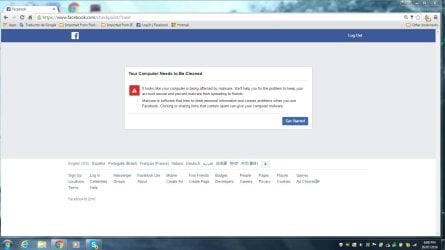

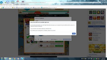

The laptop is used on Facebook. The user has suddenly become unable to either share or post anything since accessing her Zoo app on FB. There is a message that comes up stating that her computer "could" be infected by a virus or a malicious browser extension, whenever she tries to post or share. This is happening with both IE and Chrome.
The desktop was fine until this morning when she used it to access FB using Chrome. Now it is exhibiting the same issue.

Btw, these are the messages they are getting:
I'm pretty sure these aren't legit. Unfortunately, she clicked the "Get Started" button.
