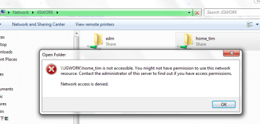

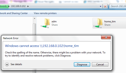

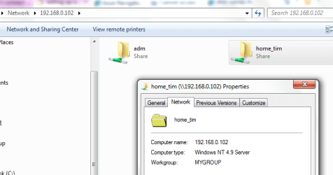

Attached Untitled.png, shows that window7 Network in file explorer can shows the two share directory on the IP address.
But when I click the "home_tim" directory, it shows error like error.png.

2. Now my laptop can see the hostname of the linux PC
3. Try either way of #3 and #5, it still does not work. attached is what windows7 tells me.

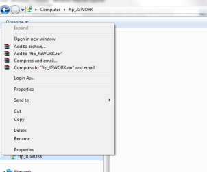

I also follow this article:
Access FTP sites natively in Windows 7 | Redmond Pie
to map the directory in windows 7 explorer. But it does not work. Windows 7 allows me to map the driver. But shows nothing under the ftp-server.

and attached is the windows 7 explorer. you can see the directory can not be "expand" and nothing shown in right-hand panel.
