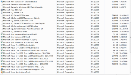

Hey it won't let me install it on my 64bit OS. I think i've been having probs with my Windows Installer lately since i got like every Win Update i possibly could lol. But since then i couldn't install a specific video editor, CS4, this plugin and a lot of things. I attached to images below one is the error i get when installing this WMP firefox plugin and the other is of all the updates i got. Should i uninstall any? Would any force incompatibilities?

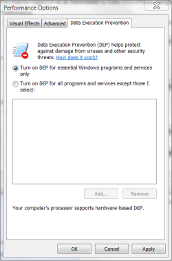

I have no idea what shift.exe is but its giving you grief. Now on to the problem. Event viewer evend ID 1000, source 100, is caused by a DEP error. dep= data execution prevention. its is in your system control panel. It should be on for all programs. It is located in control panel>system control panel>advanced settings>performance settings>DEP tab
Make sure its on and re-boot. after that we can start looking at the rest of your errors.

It's been on and shift.exe came from Need For Speed Shift. It kept crashing out of nowhere and i never figured out why but its off my computer now

Like i said ever since i updated my famework to 4 beta and installed the new win installer then updated my sql and visual stuff everything went whack. but nah there's really nothing on here i care too much about, considering everything on my computer is just a click away if ya get my drift lol. I was considering a clean install but i figured i'd wait til i get some more advice and perhaps a fix. i guess i'll go ahead and do that then. anything i shouldn't install? can i go back to the net framework 4? or maybe something more stable like 3.5? i don't think i'll bother updating my installer package unless prompted too this time :)
