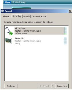

Go back into sound and go to the recording tab and see if your headset microphone is set to default.

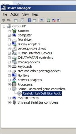

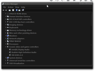

Go to the control panel and then go to Device Manager expand Sound, video and game controllers and it should list what you have for a sound card.

Thanks. Doesn't look as though the headset can be configured I'll check with the makers in case. I downloaded Dragon 12.5 from the States so unless they can send one through the post....?
