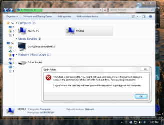

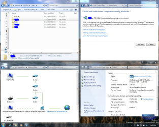

well, first thanks for the replies and interest copernicus.
Yes, both desk and mobile have same user/pass setup. But if you look in the first pic posted, you will see that i am doing all this while I am NOT on a HG, and ON a different workgroup. The only similarity if you want to call it that is the Type of network, which IS home.
