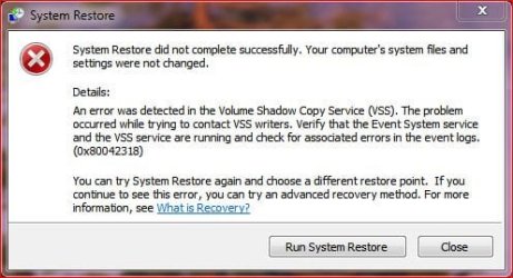

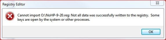

Having an issue with my system and trying to restore to an earlier state...but both System Restore and Regedit - import are giving me errors ?
Here's a couple screen shots that show the main error messages attached
On the registry...I have a full backup of my registry prior to the changes I am trying to reversed
But using - run -regedit - import...I'm getting eh partial error message in the jpegs ?
Is there a way I can manually move/copy my reg files i8n my usb external drive to my main C: drove to replace the current ( I think ) buggy registry ?

You cant restore from a registry backup inside windows because some keys will be in use. See method 2 in this tutorial.
http://www.sevenforums.com/tutorials/4230-registry-backup-restore.html

2) Per my originall post...I also am unable to do a restore point operation as the jpg in initial question indicates. Can I use the same cmd command via the install dvd to try that process also ?

2) Yes, if you have a good restore point, the same tutorial tells you how. But system restore will restore not just the registry but the system files as well.

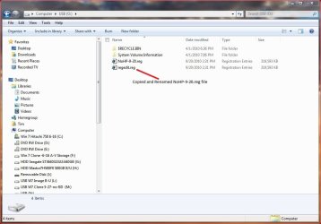

OK thanks guys for all the insight and help....1st I'm going to try the Registry Import...before any tinkering I did export the complete registry to an external USB drive.
The drive letter is: O
The exported complete registry is: NoHP-9-20.reg
In the tutorial recommended by Bill2 it says the following:
5. In the same command prompt, type regedit /s "full path to saved .reg file" and press Enter. (See screenshot below)
NOTE: For example, I only have Windows 7 installed with the 200 MB system partition it created during installation. I saved my Registry Backup.reg file to my desktop on the D: drive (from step 3), so I would type:
regedit /s D:\Users\User-Name\Desktop\Registry Backup.reg
and press Enter. Your file path will vary of course.
Would my correct command line prompt be regedit /s O: NoHP-9-20.reg ?
Or should I rename my backup (NoHP-9-20.reg) and is so to what file name...?...and is there a space between O:spaceNoHP-9-20.reg or no space ? ( "O" drive in attached jpg)
