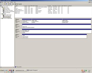

the first machine i put it into was directly into my main pc. i only loaded up win7. the drive was detected automatically. i then started formatting the drive for the first time at the full capacity of the drive. the formatting took around 7-8 hours. then it worked for a week. then i put it into an external drive enclosure which was plugged into winxp (seperate winxp machine from my dual boot system.) when i tried to put it back into my dual boot system. i tried to load up win7 as normal but windows7 boot failed. then i tried loading it up in winxp. winxp booted up but the drive wasnt working. i installed seagate discwizard for winxp and after re-partitioning the drive it worked. however. the drive isnt partitioned into 2 partitions of the same drive it seems to have been partioned into 2 100%'s of 2 drives.

I just took another (closer) look at you Disk Management screen shots. Here is what I see:
The ACTIVE partition is the partition that the BIOS looks for to boot an OS.
  • In the screenshot from XP it shows Disk 3 - Drive M marked as ACTIVE.
  • None of the partitions on Disk 0 are marked ACTIVE.
  • Disk 0 - Drive E is marked BOOT, meaning it is the OS that is running
  • The Disk 0 - SYSTEM RESERVED partition, which is usually the ACTIVE partition, is not marked ACTIVE. But it is marked SYSTEM, meaning the files required for booting are here.
From this it looks to me like the XP OS requires the 3TB drive to boot. This is a guess - like I said, a complicated experiment. Does this machine boot with the 3TB drive removed?
It the screenshot from the W7 system:
  • The Drive 0 - SYSTEM RESERVED partition is marked ACTIVE, and SYSTEM
  • The Drive 0 - C: partition is marked BOOT
From this it is obvious that W7 will boot just fine without the 3TB drive installed, which is what you have observed. But if that 3TB drive has got an ACTIVE partition (and possibly boot files) then that is going to throw a wrench in the works.
As mentioned previously, you will probably need to remove the ACTIVE flag from the 3TB drive's partition to use it in the W7 system.
But note: if the XP machine actually needs that ACTIVE partition to boot then you will have solved one problem and created another.
Can you recall any actions you have taken in trying to correct this issue that would explain what is going on here?
