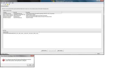

I just did a fresh install onto a new SSD and in the last day or so I have started getting the webpage has stopped working error. I have downloaded the debugdiag.exe program and have a couple of .dmp files that have generated due to crashes, but am unable to analyze or open them. They are 300+MB each and even after zipping them they are too big to upload here (130+MB).
I have attached screenshots of the debugdiag program after I try and analyze the dmp files. Any assistance figuring this out would be appreciated.
