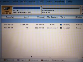

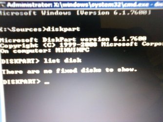

"I suggested to wipe, then create and format an NTFS partition, then mark it Active to try install. Diskpart Clean command takes 30 seconds and is all that is needed here."
- I wiped the entire disk first, and then created the NTFS partition (100gb) and set it as active. I am using MiniTool Partition Wizard and Gparted to edit my hard drive because I cannot access my hard drive via Command Prompt during windows 7 installation.

Here is a list of my partitions thus far. Thanks.

Did some more snooping and it looks like older ASUS SATA hard drives seem to give a lot of problems when trying to install windows 7 and Windows XP. Should I try a Vista installer and see if that does anything?
Test your HD with maker's HD Diagnostic extended CD scan, followed by Disk Check from the installer Command Line accessed by Shift + F10 at first screen after booted. Format one large partition to run the Disk Check.
If HD checks out then write the latest official ISO to flash stick using Step 1 and 2 from Clean Reinstall - Factory OEM Windows 7. Boot stick under USB, Removable or HD on one-time BIOS boot Menu key. If it fails, unplug the DVD drive to eliminate it.
