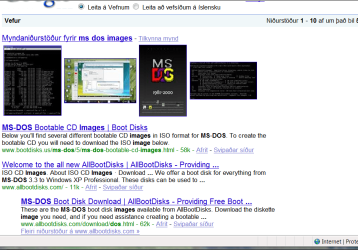

Stuck...
Ok, the first part of the installation has gone according to plan, until it restarts & tries to load files from the CD rom drive. I've got a mounted CD rom set up but it just wont accept any source drive.
Any ideas? (Pic Included)
I am having this same exact block on my Win95 install on VirtualBox. I'm assuming that during the installation the CDROM was mounted as a different drive? How did you crack it Orbital?
Actually wait I figured it out. I installed DOS 7.10 first, then through that I installed a copy of Win95 over it and it works flawlessly... with sound!
