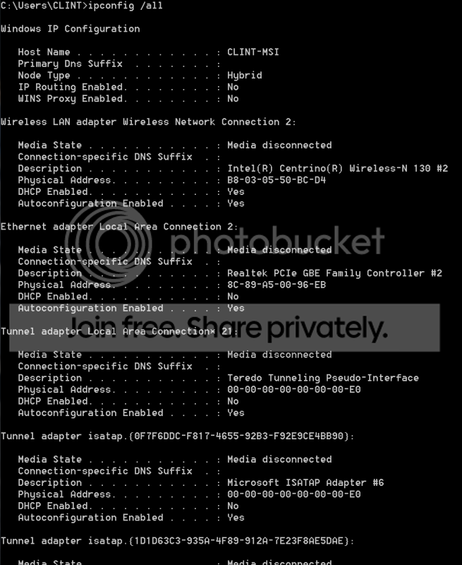

Here's my ipconfig.

Here's my ipconfig.
Yep, no connection showing up here at all. DHCP is also turned off for the wired connection so I assume you are using a static IP for that.
Try running the file below which will reset the network stack, renew the IP and flush the DNS among other things, it will also reboot your system after it runs. Let me know if this changes anything.
