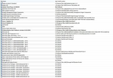

Have you verified that only one program is making backup?
Somewhere on the forum a couple of days ago a member had (2) programs making backups.
One he/she intended and the other came with another program that he/she didn't know came included with a backup add-on. They both were making backups.
Good point and yes I did made sure no other backup software is there.
