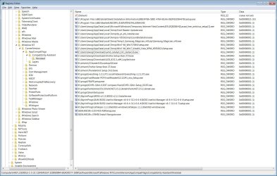

On a 2 months old windows 7 installation, I discovered that many setup.exe's are in a register compatibility mode:
HKEY_USERS S-1-5-(very long number) Software Microsoft WindowsNT CurrentVersion AppCompatflags Compatibility Assistant Persisted
There are other places in the registry for Compatibility Assistant, but these do not have any entries.
I have 64 bit windows and some of the programs are clearly 64 bit, others are 32 bit, but none are for the 25 year old windows NT.
See screenshot.
What to do with these entries? Delete all of them or some of them, or leave them (in case they are harmless). NB I got no warning that windows was doing this. Should I prevent windows from trying (and failing epically) to help in this manner?

I would leave them unless you did something strange during their install.

"I would leave them unless you did something strange during their install." No, I did nothing special during install, I followed the current advice not to disable windows features (except hibernation). I installed win7 and ubuntu on an ssd, made symlinks to a hdd, and use a monitor plus a tv. This took some time to install and prepare.
