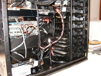

Moving my rig into new Full tower case.

Thanks to all who wrote with there knowledge and ideas. The build when crazy good started at 7:00pm and went to 2:00am the next day...lol. Quit at 2:00 and took a good look in the morning then fired up, found a couple of issues like I'd moved my wireless card from one slot to the other and had to move it back to work. Wired up all the drives just as before and it booted flawless. I didn't have long enough power cables for the drives and 12V board but all in all it came out tidy ! What say you ? Cheers to all !

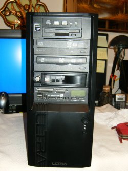

HPIM0909.JPG Old Ultra case
HPIM0910.JPG Old internals

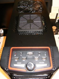

HPIM0923.JPG New Thermaltake Element V
HPIM0924.JPG New Top view note filtered air in and 200mm out

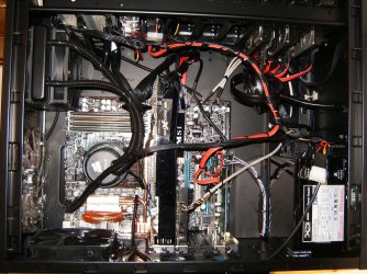

HPIM0928.JPG New layout for internals

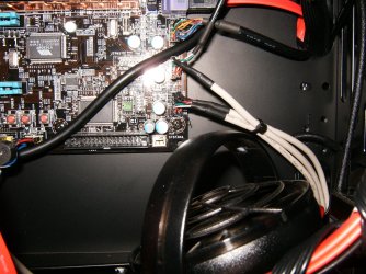

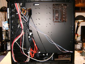

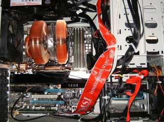

And the tweaking continues. See new dual bay SSD dock, new dueling Lite on DVD drives. Inside I've moved the spot fan and reorganized all cabling. Need to get a 12v extension cable and then some molex extensions and I will go for as much behind the mobo as possible. If possible a Crucial SSD via Sata III and then she's done for quite some time other than possibly dual monitors ! Please someone stop me !
