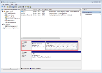

The 100MB partition is for Repair purposes and should automatically be a part of the installation hard disk (even though it's an alltogether seperate partition).
You may want to check to see what disk the partition has been assigned to, run Computer Management from the start menu search box. See the screenshot and you'll notice that each disk is broken up into partitions (see highlight for Disk 0).
As for changing this option i'll look more closely into it for you :)

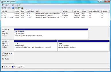

EDIT: Okay, here it is. As you can see, there's no sign at all of the "System Reserved" partition. Just to be ultra-clear:
* Disk 0 is the Win7 setup flash drive, connected by eSATA. If I unplug it and try to reboot, the old "DISK BOOT FAILURE" message appears.
* Disk 1 is the main hard disk, split into a 30Gb chunk for Windows to live in, and the rest for general files and whatnot.

If you read the thread i linked i explained my theory that the boot files are put on the first "active" partition it finds, so yes in your case that is the flash drive. Possible fix would be to mark the boot drive active, burn the dvd, disconnect flash drive, and boot from dvd and do a startup repair.

I... should've thought of that before ;) Thanks a ton YupYup, that seems to have done the trick! A startup repair later and everything seems to be as I want it :D
