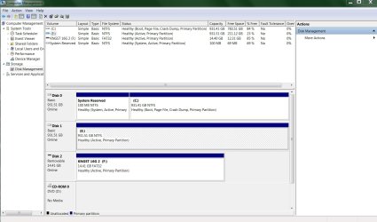

Thank you, Samuria. I found Disk Management in Windows 7, and took a screen shot. The file is attached.
