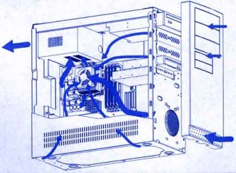

I think they all work the same

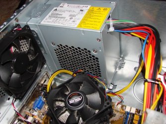

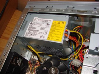

Here's the pics .. One in a HP big box d4996t .. The other in a HP the same size as yours m7690y
both top mount ...
