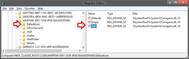

Double check the registry location below to see if it's the same for you.
HKEY_CLASSES_ROOT\CLSID\{645FF040-5081-101B-9F08-00AA002F954E}\DefaultIcon
You might also run a SFC /SCANNOW command to see if a system file may be corrupted causing it.
The registries looked the same and SFC /scannow showed no errors. Weird.
