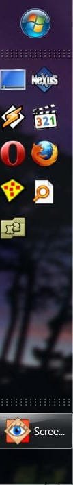

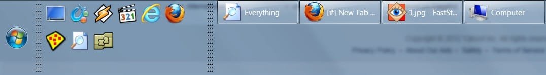

I think I've verified that there is some kind of bug with the quick launch bar. I was messing around with the taskbar--moving it to the different sides of my screen, resizing the taskbar, resizing the borders of the quick launch bar, etc.-- when I noticed the icons in the QL bar didn't have the wrapping problem when the taskbar is on the left/right side of the screen:
I also noticed I can freely resize the taskbar to any length I want when it's on the left/right side of the screen. When it's on top/bottom I can only resize it in set increments (1 row in size).
Then when I dragged the taskbar from the side back to the bottom the QL bar remained wrapped:
Unfortunately if I restart my pc the wrapping problem returns but this proves that it is possible for the quick launch bar to wrap the icons properly. I wonder if there is a way to fix this. The solution is probably connected to how the taskbar freely resizes when it's in a vertical position. If we could have the taskbar in the top/bottom position resize the same way maybe that could solve it?
