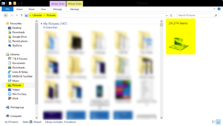

This as I said only the Pictures Library, not counted all those thousands and thousands of images already archived on Archive and Backup drives.
I am not a photographer, not even a keen photo snapper when on holidays or otherwise, yet I have these thousands of photos. What about you, maybe a hobby photographer with 15 years of active photo taking, all stored on a computer? Or an aspiring writer, hundreds of short stories and poems just waiting the day you will be discovered?

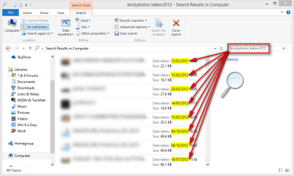

To use filters you simply write them on the search field on either File Explorer (Press Win + E > Type in Search field) or Start Menu Search (Press Win > Type in Search field).
Searching photos from 2012 on File Explorer:
(Notice that the date of files show they fit our criteria, taken on 2012. Screenshot from Windows 8 but Windows 7 acts and behaves exactly the same way.)

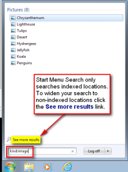

Searching images with Start Menu Search:
   Note
The main difference between File Explorer Search and Start Menu Search is where they search.
  • Using File Explorer, the Windows Search searches both the indexed and non-indexed locations starting at the current selected folder or drive plus in all its subfolders. Examples:
    • File Explorer open on Computer > Search will search in all folders on all drives
    • File Explorer open on drive F: > Search will search in all folders on drive F:
    • File Explorer open on D:\PDF Files > Search will search in folder D:\PDF Files and all its subfolders
  • Using Start Menu Search, the Windows Search searches only the indexed locations (after fresh install normally only your personal and public folders). This is the faster method to search but as it only includes indexed locations, you need to be sure to save your files only to indexed locations in order to keep them findable using Start Menu Search.

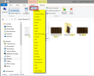

This screenshot shows the most common Kind parameters you can use (highlighted list). As the Windows Search is the same in 7 & 8 you can use these parameters even though the screenshot is from Windows 8:

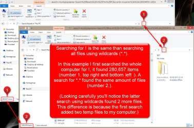

unexpected search results
Not sure where to put this, so this looked close...
I did a search from start --> search box, entered the "!" symbol only, and got a result of ALL the shortcuts on on C: (based on my indexing options). Is this by design, or did I stumble on one of the "hidden" goodies in win 7? Not complaining, just curious.... :huh:
Windows 7 Ultimate x64dual core @3.20ghz4GB
Dell Inspiron 560
dual core @3.20ghz
4GB
Realtek hd & intel hdmi
Dell 21.5"
1920x1080 (running 1600x900)
internal 500GB
ext buffalo hd-pntu3 1TB
Dell wireless
Dell wireless
50/25
MSE & SAS
Canon Pixma MX410 Printer
Altec Speakers l-center boom-r
See the below screenshot for explanation. Notice that screenshot is from Windows 8.1 but the same applies to Windows 7.
