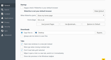

As a test you could try firefox and select save downloads to downloads or any other location, i tend to default to desktop,
see screenshot (although its Waterfox, firefox has same default screen options)
Roy
