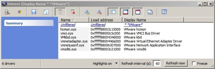

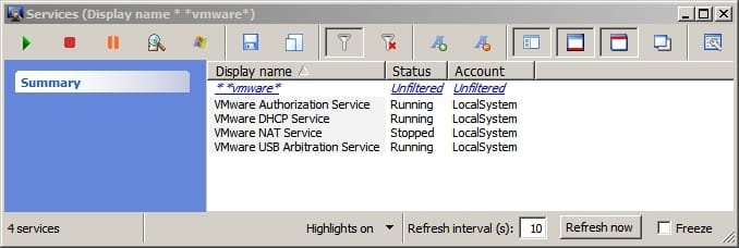

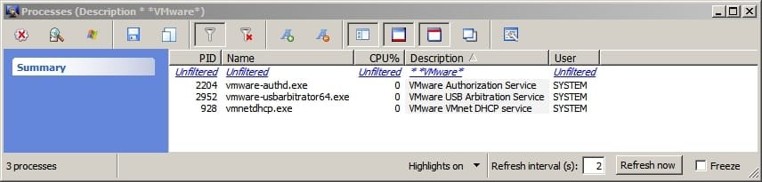

Thanks Chris. That is very interesting. It is probably those left over processes that need to get shut down. Maybe I should see whether the fast shutdown tweaks would help.
