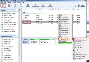

Check and change your incorrect drive letters one at a time:

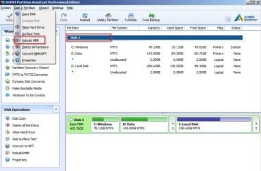

Then rebuild MBR:
Then shutdown and unplug USB. Boot and see if it boots into windows.

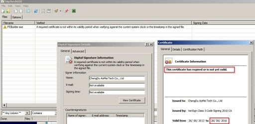

Okay I checked and the certificate has expired. They need to update it. The program should still work but I'm not really sure about using a PE Stick created on a windows 8 machine on windows 7. It's your call if you don't want to try it.
