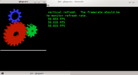

I'd switch to VMWARE (VMPLAYER is FREE) as it supports 3D rendering etc.
1) Uninstall Guest additions from VBOX
2) Run VMWARE CONVERTER (also free) to convert the VM to VMware format
3) Power up the Guest VM
4) install VMware tools
5) re-boot the guest -- now it should work perfectly (enable 3d and video hardware acceleration in the vm settings).
I assume you are running on a WINDOWS HOST.
If running on a LINUX Host you have to edit the VM's configuration file as well.
Add these lines :
mks.enable3d="TRUE"
mks.gl.allowBlackListedDrivers="TRUE"
One of these lines might already be in the config file - ensure there's no duplicate line or the VM won't start.
ensure also packages DKMS and libtxc_dxtn (or similar) are installed on your HOST - this will enable 3D etc (S3TC) on the HOST. (LINUX).
Again for Linux Hosts - with VMware player rel 7 (latest one) you might see a message 3D support not available from the Host --- this is actually INCORRECT if you have made the changes listed in this post. 3D rendering works fine as you can use DIRECTX to check it. With VMWARE PLAYER release 6 you won't see the message.
On the Linux host run command glxgears - this will show that your 3D is working on the HOST. (again Linux). Screenshot enc from laptop. CENTOS7 HOST running W10 Guest (X64)
