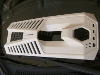

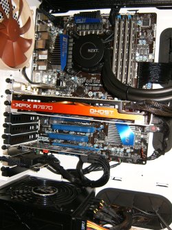

I've done a quick search and I think you may be very challenged to get any true Mid-Tower to except a eATX mobo. It looks like the best you can do is a full tower. My case has a handle and to say I love this thing is such an understatement but it will take ATX and XL-ATX not E-ATX, one being greater width (E-ATX) vs longer height (XL-ATX). Also your price point is going to be the real challenge.
