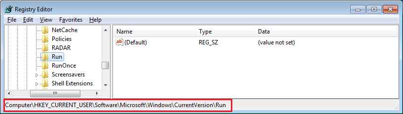

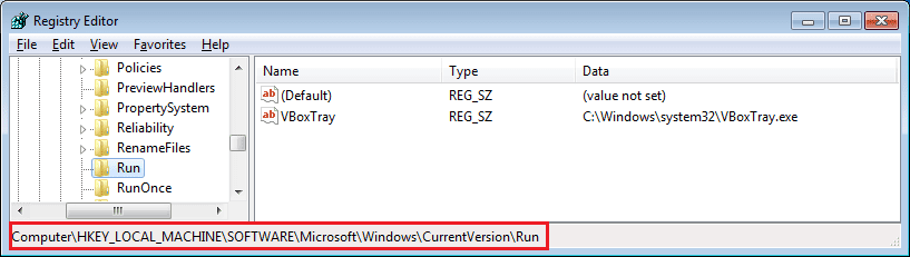

...you can check to see that explorer is listed here:
And while you are in the registry, check these two places:
If you have any doubts about what you find, please post a screenshot before removing an entry.
