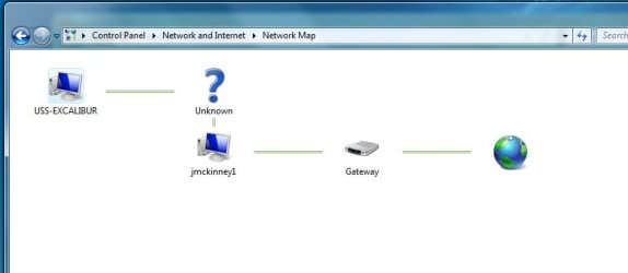

OK per your recommendation I diabled firewalls completely. That solved it on the XP side...I can now see and access files on the Win7 machine from the XP machine. But on the Win7 side I still can't see the XP machine. Attached is the map that gets displayed...as you can see the XP box shows up a question mark and is not selectable. The jmckinney1 box is the laptop (not worried about accessing it).
What am I missing??
Thanks.
