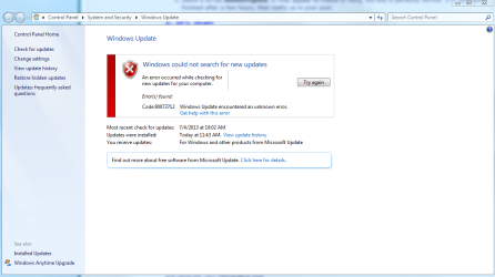

The error code for the update is: 80073712
The behavior of Windows Update is the same every time I open it after leaving it alone for a while:
1. I open Windows Update. It tells me there are some updates I should install (10 important, 2 optional).
2. I click Install updates. It takes about 30 seconds, then I see "The updates were successfully installed" with a green check and everything. Cool.
3. I close it then re-open Windows Update. Now says "Check for updates for your computer" with a red X. Not as cool.
4. I click Check for updates. About 10-20 seconds later it says "Windows could not search for new updates" and shows the error code 80073712.
5. I close the window and can repeat from step 1 indefinitely.

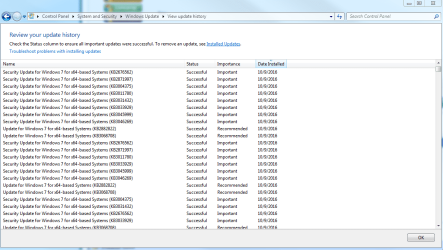

Sorry, I'm not sure what you mean by that. It says last check for updates was on 7/4/2013. Do you want my update history? Here's a screenshot (let me know if you need to see the whole list - there's a lot apparently).
Also, I just ran CCleaner's Registry cleaner. No visible effect on Windows Update.

Your machine looks upto date, update wise last successfull install was 9/10.
