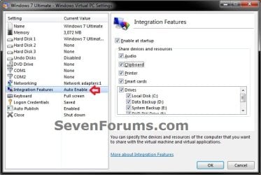

1. Open the Windows Virtual PC settings for the virtual machine than you want to select host device to share with.
2. In the left pane, select Integration Features. (see screenshot below step 5)
3. To Not Share a Host Device or Drive
A) In the right pane, uncheck the device or drive. (see screenshot below step 5)
4. To Share a Host Device or Drive
A) In the right pane, check the device or drive. (see screenshot below step 5)
5. When finished, click on OK. (see screenshot below)
