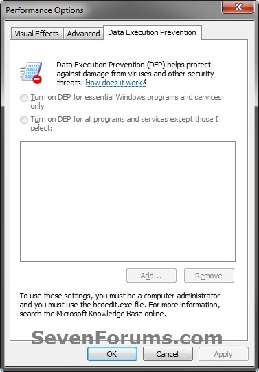

    Copied this from your post #1. Where is this window?
    Typed Performance Options in Search and found nothing.
    Hi Mike,
    That's in advanced system settings, performance box, settings.
    Attached Thumbnails Attached Thumbnails Enhanced Mitigation Experience Toolkit  (EMET)-capture.jpg

    Found the window.
    DEP tab selections are grayed out as you said it would be so I guess everything is working properly.

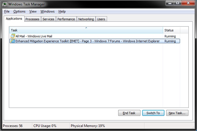

    Hey Brink, I just recently encrypted my virtual page file. Before I encrypted it, I installed the EMET program first. At this time, when I opened task manager and had IE running, the description would include something like "EMET- Internet Explorer- Bing." However, after encrypting, it is now just "Internet Explorer- Bing" Did the encryption do anything to EMET or affect it? Or maybe I am just seeing thiings...?
  9. Posts : 73,219
    Thread Starter
       #28
    Hello Windows 911,
    Nar, I don't think it would have. It sounds like that would just be the title of the tab that you may have had open (active tab) in Internet Explorer displaying in Task Manager at that time vs now instead.
