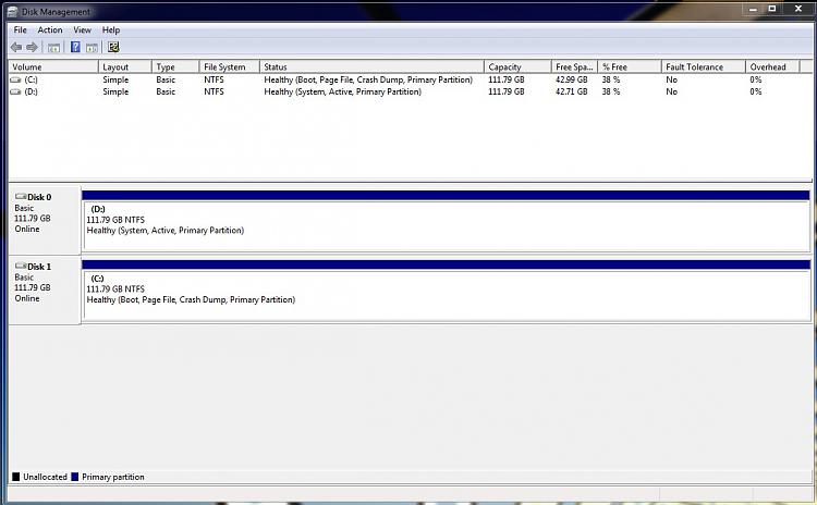

    First, my system was setup as a dual boot, xp and win7, with win7 the default. So when pc boots, it goes straight into win7 as default after lingering a few seconds on the dual boot menu. Can I still just follow the sysprep guide once both drives are hooked into new mb? Or do I need to do something to the dual boot? ( I really don't plan on going back into xp, but that drive has lots of linked data from win7) I attached an image of my system drives. C: drive Disk 1 is the Win7 and D: drive Disk 0 is the XP.
    Second regards AHCI mode. My older motherboard is just plain ide. I know one cannot just change the bios from ide to AHCI as win7 will blue-screen. But after running sysprep and plugging into new MB, can I set the new MB to AHCI mode on first boot and let win7 reconfigure for such? I guess there is some improvement overall with AHCI and ssd's over plain ide mode.

    The Disk0 (XP disk) will be not affected in any way, your dual boot should work as before also after the sysprep. If any dual boot issues occur, you can always create a new dual boot menu with BCDEDIT. A worst possible scenario is that the dual boot is gone but all the content of disk0 is still there and can be accessed.
    Switching to AHCI should also work without any issues. Sysprep and shut down, replace the motherboard, on first boot go to BIOS and change to AHCI, let machine boot normally.
