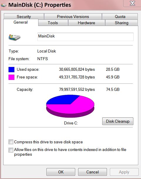

    Any suggestions please.
    Windows update error today (Win7 Ultimate).
    Suggested run sfc /scannow.
    Ran it from elevated command prompt, and it stopped after just a few seconds saying no errors found!
    I expected it to run for a few minutes at least.
    Anyone had this before?

    Hello Paul,
    That is a bit fast for a sfc /scannow run.
    How large is the partition that you have Windows 7 installed on?
    Could you post a screenshot of the CMD window showing all of what it said for this in case there may be something else that stands out?
    Could you also upload a copy of the sfcdetails report from OPTION THREE to see if anything in the log file may say why?

    Hi Brink,
    Hopefully 3 attachments have the details you require.
    The partition is the drive, nothing else on it, I only use it for the OS.
    TIA,
    Paul.

    Yeah, that's to fast. It appears to have been interrupted.
    I would recommend to run disk check on your C: drive to check it. Afterwards run the sfc scan again to see how it does.
    If SFC is still that fast, then you might run the sfc scan at boot instead to see how it does.
