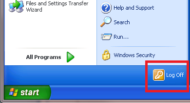

    @DJFarmo: The lack of Shut Down button is easy to explain. Check these two screenshots out. First XP Mode with integration features enabled:
    Then the same XP Mode, this time integration features disabled:
