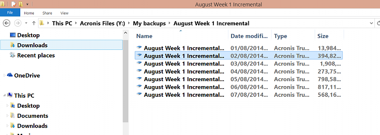

  10. Posts : 112
    Windows 7 Professional x64
       #359
    Thanks :) (and that's not paranoid)
    I've never had any problems with Acronis tbh and use it and trust it implicitly. I run daily incrementals (weekly cycle), full monthlies and also back up user files to flash memory as and when. The monthlies I move to an external drive.
    Now my friend with the new W7 install....... if we get one or two backups a year we'll be doing well :)
    Attached Thumbnails Attached Thumbnails Clean Reinstall - Factory OEM Windows 7-partitions.png   Clean Reinstall - Factory OEM Windows 7-acronis.png   Clean Reinstall - Factory OEM Windows 7-acronis2.png
