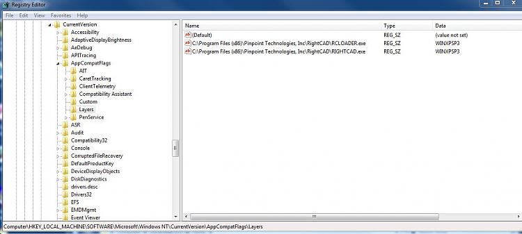

    REG (Option 3)
    I am lost with how to do this via the registry for all users. HKey Local User? What is that? Did you mean Hkey_Local_Machine? I did add the entries there and went back to the .exe and did properties and noticed nothing changed. help please.

       #94
    Hello Deano, and welcome to Seven Forums. :)
    Yes, it's HKEY_LOCAL_MACHINE for all users.
    Could you also post a screenshot of what it shows in OPTION ONE for the program?
    Have you already restarted the computer to see if it changed as per OPTION ONE afterwards?

       #95
    Thanks for the quick reply. Here is the screenshot of the .exe
    and also the screen of the registry.
    Thanks for your help
    I did reboot as well Brink

       #96
    You might also set this in the HKEY_CURRENT_USER registry location as well to see if that may help.
    Using OPTION ONE would be much easier though.
  8. Posts : 3
    Win7 64bit
       #97
    Yeah i think it has to go in current user. i am trying to make it a non-manual process (and not put something in startup of all users), but looks like i will need to manually touch each workstation.
